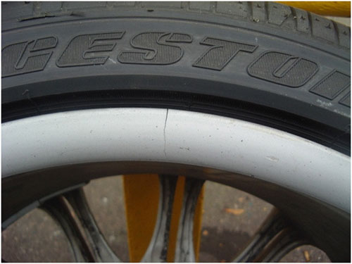

Most people would know that the tyre full of air has a reasonable level of compliance acting as our first line of defence deflecting the poor road condition however things appear to be quite different with the Run Flat. By compromise, all BMW's fitted with RFT's have downgraded (softer) suspension to absorb the migration of these road shocks. Unfortunately this doesn't appear to be perfect as we are starting to notice that this shock migration appears to transmit some of these forces to the wheel rim, and actually cracking it in some cases without amazingly, any apparent harm to the tyre itself. We are currently monitoring this but it is something that owners of Run Flat Tyres must keep a keen eye on and in the avoidance of doubt... stay away from pot holes.

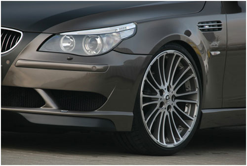

The consequence of camber alone conically deforms a normal tyre sidewall, however if the correct maths are used in suspension adjustment, geometry and alignment thus allowing the cars weight to be evenly distributed across the tyre, all can be encouraged to work together in harmony.
The problem some BMW's have is that the RFT's do not deform and do not allow a conical profile because of the rigidity of the tyre and sidewall, meaning they cannot distribute the cars weight evenly easily, but before you depart your beloved BMW in despair, once again we have solutions to address this.
We can establish the camber curve and adjust the chassis accordingly allowing the RFT to maintain a solid, predicable footprint during the suspensions transitions. Our chassis adjustments belays the fact the RFT cannot deform, maintains the BMW handling and prevents the adverse tyre wear. Once again, regular alignment checks and calibration by Wheels In-Motion will maximise tyre life and handling without compromise. It just needs a little more thought, care and attention.
